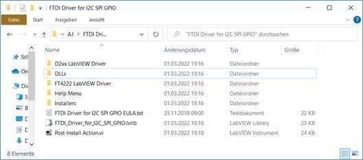

    Thanks for your very fast reply. Maybe I’ve not correctly described the problem.
    FTDI Driver Saved Location on Program Files x86
    I think all files have been installed, …

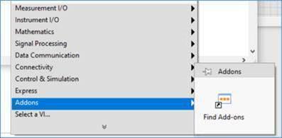

    FTDI Functions not seen in palettes
    but I cannot see them on the palette.
    FTDI AJ not seen in quick drop
    Followed  your advice, but “AJ”not found.

    My LabVIEW version is: 2017 SP1
    Do you have any idea?
    Thanks in advance and best regards,
    Bernhard
