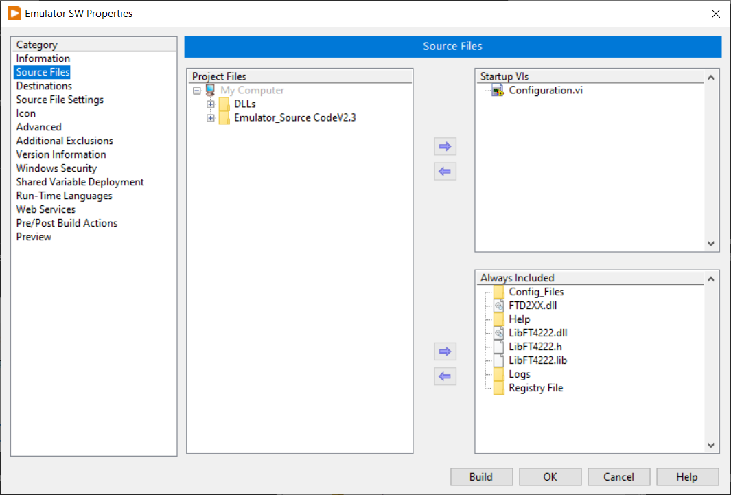

This is the EXE build Property window.

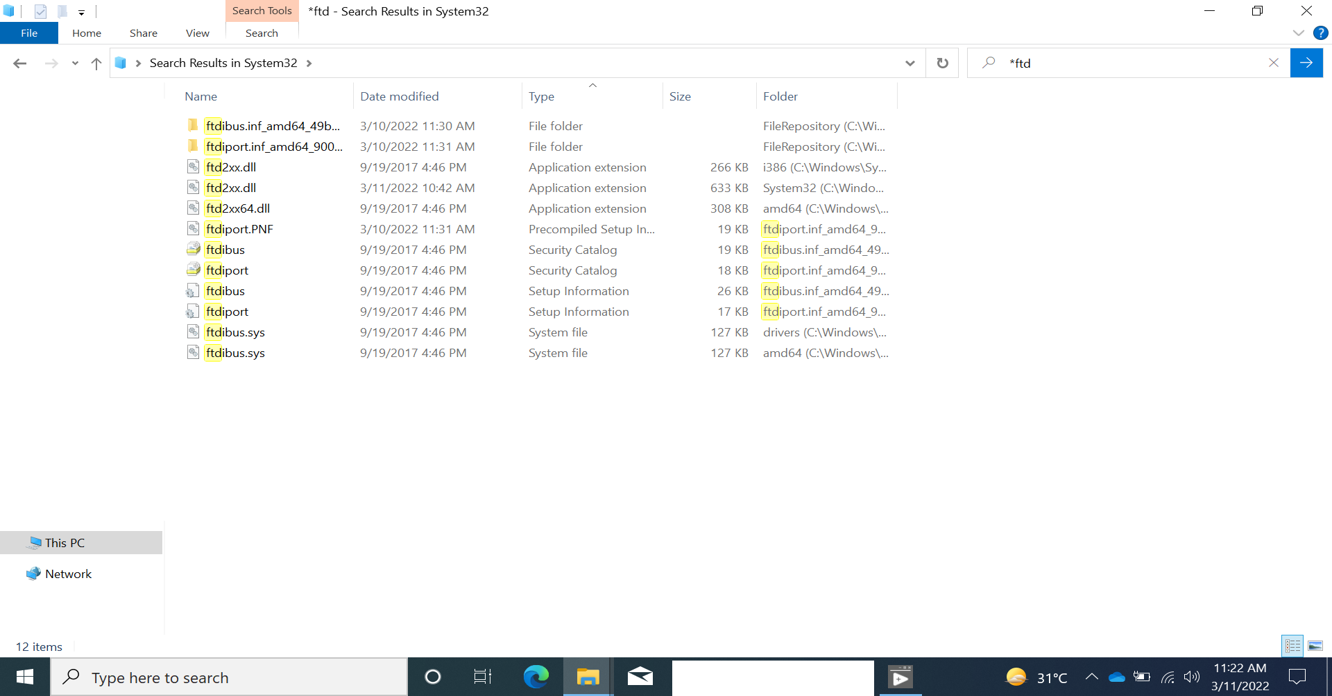

We have also shared the FTDI driver window in System32 for your reference

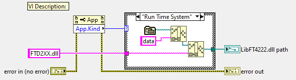

FYR: Below is the screenshot of the logic used to find the DLL location in driver.

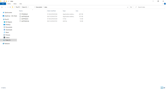

As you have mentioned the FTD2XX.dll is located in the data folder. I have attached the Screenshot of the EXE data folder.
